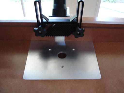

                I have the one from Rockler. It is 1/4" Aluminum and is perfect. It also has holes for a starting pin and to mount a dust collector/ Bit cover.

                      Another option would be to make your own from a 1/4 plate of aluminum. I did this and it was actually easier than expected. I made a template out of MDF to fit the opening and flush trimmed the aluminum using an inexpensive router bit. It's been a while but the aluminum itself was less than $10 IIRC for a remnant piece. I picked it up at http://www.imsmetals.com/ . The only trouble I had was making a fitted insert for the different bit diameters. To resolve this I just made two router plates, one with a smaller opening and the second for larger bits.

                            Yes you can. Just make sure you take small passes to keep the temperatures down on the bit as well as the aluminum. It's a very soft metal and has similar characteristics to a really dense hardwood. I've done it many times and haven't had any problems. The bit I used for my plates was a holbren bit and it's still sharp after 3 plates.
                            Edit: Use slower rpms if possible.

                              If you don't want to use a router on the aluminum, you can simply get the aluminum at a local metal shop, and they'll stamp it out whatever size you need. I did my first one that way, and it only cost a couple of bucks. Then, you just grind the corners round, and drill your own holes. Worked just fine, before I went hi-tech...
