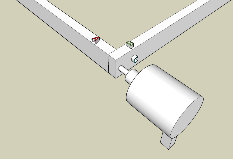

    I am doing some framing w/ a framing nailer and am wondering about the risks. Here is a picture I made to identify various places one might put their hand to hold the workpiece in position for nailing. Which positions (A, B, C) are OK, which are risky and why? Assume these are 2x4s.

    A is the best place to have your hand. You should hold the board with your thumb and all fingers except your pointer, use that one to hold the boards flush. You should nail the bottom of the board first and then slide your hand away from the gun to put a nail into the top of the boards. B and C aren't so good because you have no control of the board you are nailing, it will slide away from the plate as soon as you shoot it, and there is no good way to hold the stud. B and C are both dangerous because it puts your hand in front of the business end of the nail gun. Thats bad cause they have a tendency to double shoot or bump and fire two nails. Just remember to keep your hand well enough back to protect yourself from misses or if the nail curls over and out from a knot. Sorry I don't have any pictures.

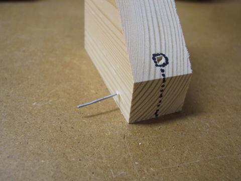

              And, though I've posted this plenty before, here's one of my nailing experiences (brad nails, though). The shot was meant to go straight down, but notice how it followed the growth rings on this soft wood:

                If you HAVE to hold it with your hand. Position A is correct BUT about 12+ inches away. My brother frames houses for a living. He has shot his hand several times, until he learned to keep it further away from the end.

                  Yeah, no contact trip for me, strictly sequential. And I'd be wary of holding the work anywhere long the nail travel direction. Using a sequential trip, which does not fire on a bounce, I tend to hold at C.

                    After taking another look I would say A or C depending on which way you are standing. As in the diagram I would hold the gun in the right hand, and hold the wood in position A 12+ inches away.
                    If the joists were turned 180 from as shown. Then I would be holding the gun with my right hand and holding at position C about 12+ inches away.
                    I would rarely hold the gun with my left hand, and hold the wood with my right. It just doesn't feel comfortable doing that, specially for a long period of time. For one or two here and there yea, I would hold the gun with my left hand.
                    I normally try to hold the wood 2-3 times the distance as the length of the nail.
