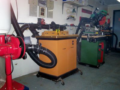

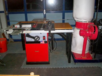

      Morning blame...
      For the tools you mentioned it works just fine with direct hook-up and a short run from DC to machine. It will work fine also by Y'ing the 4" to Two 2 1/2" to a router.. miter.. DP.. etc. Keep the TS at 4".
      If you have a larger BS.. jointer.. planer.. it won't work find and you need more muscle as Jersey Frank already stated. "Big load.. big hoss- small load.. small hoss"...
