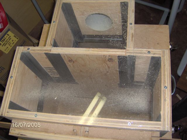

    Cleaning the DC can be annoying if you have DC with bags. Separator makes cleaning less frequent because most dust supposed to stay in a can. Whether it does or not - depends on what you build. The risk is that DC too powerful and can too small combination results in DC overpowering the separator and sucking everything right through. 1.5HP should not be too strong. The opposite side risk is if you make an elaborate plumbing with DC hooked up to several places at once - the separator will reduce the suction so there will be not enough left.
    I don't have a DC like yours - mine is very small and I was afraid that collector will reduce the suction too much. The result I built not a cyclone separator which takes very little pressure and it works well. It is using a very small can (10 gal) and 80% stays in. The can and DC are mounted on same platform and roll together. I connect 1 machine at a time and DC rolls to the machine I use at the time.

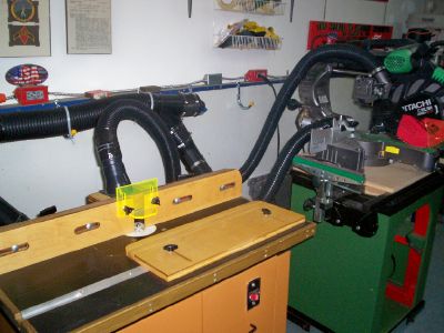

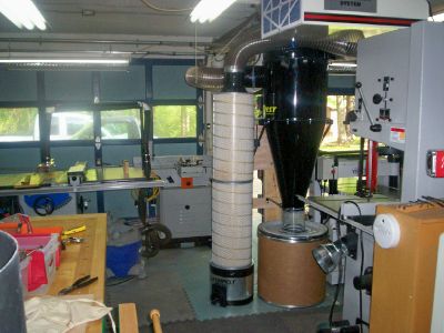

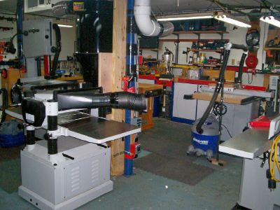

          Morning FP...

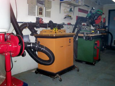

          Before just installing a PS cyclone, I used a separator with my small 1 HP PS DC and it worked great dropping large stuff in the can. Vaking "nailed it" with stating that rolling the DC to the machine is the "ticket" if you use the separator. A separator will reduce air flow and air flow is what is necessary if you set up a ducted system.
          I kept the PS 1 HP and took the separator off to use a 4" hook-up to my SCMS and router table with a Y to get a 2" hose to fence and lower cabinet with the router and fence and dust port on the SCMS. But... after taking the separator off.. I replaced the bottom felt bag with a plastic disposable offered by Penn State. I can see when it fills to the point I need to empty it and I will add that "don't let it get too full" as it will reduce air flow and fine dust will be forced out the top filter bag.
          The cyclone speaks for itself.. I did not run an elaborate duct system as I got wise and centered the "clone" and then circled my major dust makers (20" planer.. 8" jointer.. 18" BS.. Unisaw) around it. That gives me the longest run of around 16" feet with 6" pipe from the cyclone direct to each machine which have all been modifed with 6" dust ports. Takes about 1 minute to switch the 6" pipe from one machine to another.
          And I will add.. my guess was correct that by keeping the run short.. minimum drops and no reductions at the machine, it willl literally "suck your shirt off". I placed a wire screen where my flex pipe meets PCV connector and we placed a T-shirt on the floor about 6" from the mouth of the flex pipe. When we turned loose of the shirt it launched into the pipe with the speed of a ground to ground missle after it hoovers just after leaving the pad and then "gone down-range". I was impressed with the results.
          Regards...

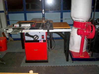

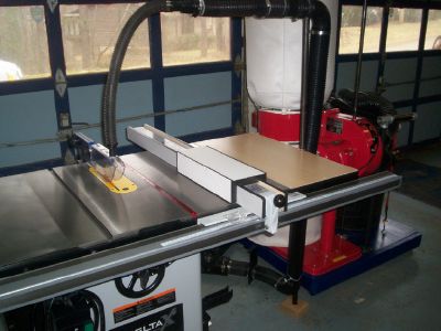

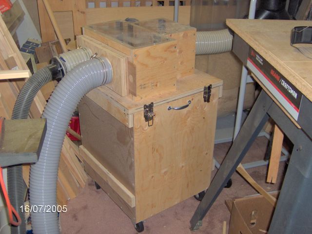

                I have the same DC and a shop made seperator. I think it works very nicely! I have not noticed major drop in air movement (even with jointer and planer) and it is a lot easier to empty the seperator! As you can see mine sits next to my DC .
                Turaj (in Toronto)
                  As I commented before, I love the way you did this layout.

                    sarge, i love your setup, its really well organized - i am far from that. at the end of the day, i have to push everything back into the garage. i saw your can with the curved plastic cover for the seperator in an older post. that is the same one that rockler sells. in your opinion, is it worth just getting that one and a can or get a can and make one like woodcraft's website shows?
                    thanks for the pics turaj. i like the clear cover idea, that was neat. now does that mean the seperator doesnt need to be circular? also i see three pipes, 2 4" and one 2", what is the third pipe for? and can you explain the two top comparments (one big and the other small)? i see the latches on one side of the lid, how do you empty it, isnt it a little too heavy (the weight of the wood cabinet alone) to lift and dump?

                        Evening Jeff...
                        Thanks for the compliment, it's working out real well... I think as I have been painting for several weeks and would love to get back to the shop to start a bedroom suite and challenge it.
                        "BTW, do you have any posts on your RT"?... Jeff
                        I must have been on that ladder too long. I think you are referring to the Router Table (RT) but do I have any post on it? Am I missing something in my exhaustion or did you mean pics or pictures?
                        If you would be so kind as to clarify so an old man can give a proper answer if within my power.
                        Regards...
