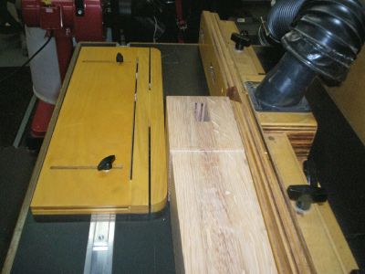

    I was looking at your springboard you have pictured in a lot of your shop pics. I see lots of refrences on the internet about using them on routers, but not table saws. Do you use yours on your table saws or just routers, and is there a danger of pinching the "work" after the blade and causing kickback. Or, is it splayed out away from the fence after the blade so that it can't initiate kick back?
    Thanks for the input fellas.
    RS
    Morning RS...
    Good question and I will tackle it with my best shot. First... there is nothing past the blade on my TS. I did a picture in haste one evening that got posted that showed it hasitily set up without thinking. That may be where you percieved the idea.
    The spring-board on my TS goes only to the point of the final cut that severs the stock.. And that is true with the Euro "short fence" I built and use reverently. The whole point of the spring-board and fence is for support "only" till the cut is complete and a free zone is created after the cut to "avoid" the pinching and possible kick-back you mentioned.
    I do extend it past the cut on my router table, which works with a cutter-head that takes its bite in a different manner than the down cutting front teeth of a TS and the dangerous "rising" rear teeth that are mainly responsible for kick-back.
    Hope that answers your question and if not.. shout! I will post a more detailed picture of the spring-board in action on the TS. If you saw the one with the SB going beyond... please.. please dis-regard that as it will put you in the same boat that a long fence is capable of producing if you get some "squirrelly tension filled stock".
    Regards...

      Can the spring board be mounted on the router table fence and used to hold stock down also???

        I use a springboard for routing, but do not use it on the table saw.
        Mine is cut from white UHMW, using the design shown in Sarge's pictures. It fills the area between the miter slot and the oak strip against the fence. It works very well for routing grooves in board edges (as shown in the picture). Normally, I would also use feather boards to hold the board down against the table surface.
        You probably already know that Sarge's comment about never placing any feather boards or other blocks past the center of the blade is excellent advice.
          Sure ... this is typically done when you're using a profile like a beading bit that would ruin the cut if the workpiece lifted up.
          For most routing operations with small or narrow workpieces, however, a sled that holds the workpiece and rides along the fence is far preferable to using featherboards. The sled affords better control by giving you something larger to hang onto, and it gets your fingers farther from the spinning bit in case the workpiece shatters. Featherboards should only be used to control stock on a router table when there's no other way.
          EDIT: +1 on the table saw comments. Devices that hold the workpiece down can be used anywhere along the fence, but devices that hold the workpiece against the fence should never extend beyond the centerline of the blade.
