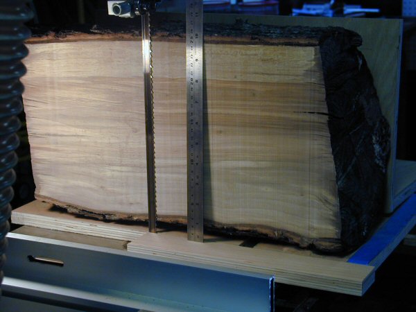

    I suppose the first question would be, does the 1 1/2hp motor really have what it takes to fullfill the 13" resaw capacity in the specs? I couldn't immediately lay hands on a 13" chunk of stock, so a 10"+ diameter block of Cherry, 18" long had to do for the test. This Cherry has been air drying for over a year and spalting has started on the exterior.
    The BladeRunner II blades had not arrived from Iturra so I initially used a 3 TPI Timberwolf blade.

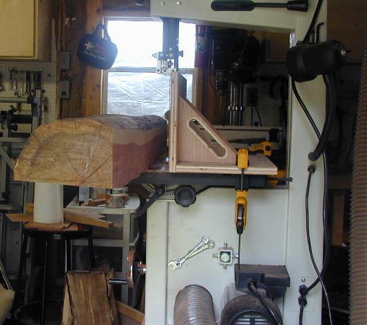

    I am using a BS jig from a recent issue of Wood Magazine.
    The jig rides in the miter slot of the BS table.

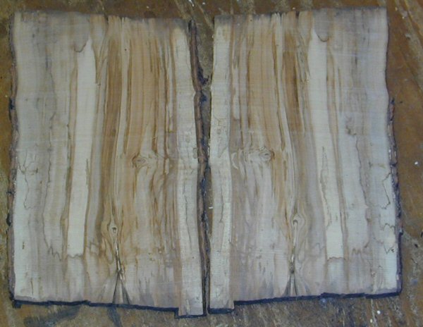

    I made several cuts at 7/8", several at 5/8" and then at 1/16".
    These will be nice bookmatches when finished.

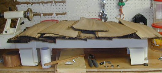

    1/16" veneers that need conditioned, stacked and pressed.
    I had problems with the 1/16" slicing with the Timberwolf blade and stopped after ruining 2 slices. The BladeRunner II's arrived and I proceeded testing the saw.
    On the Cherry with the BladeRunner blades the saw didn't act like it knew it was sawing 10" stock. I could not feed fast enough to hear any loading on the saw. On all cuts the slices were within a few thousand's top/bottom and end-to-end.

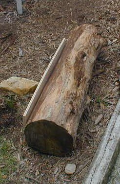

    A 46" long piece of Cedar, 10" dia. on one end and 9" dia. on the other end had been tempting me since the LOML treated me to the Rikon. Yesterday I asked Tina if she would help me resaw it. I attached a piece of ply to one side to stabilize it against rolling on the saw table.

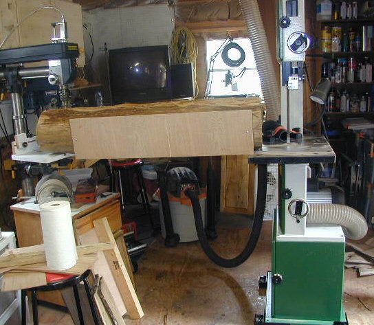

    We brought it into the shop and readied it and ourselves for the task.
Name:	ready toCut.jpg

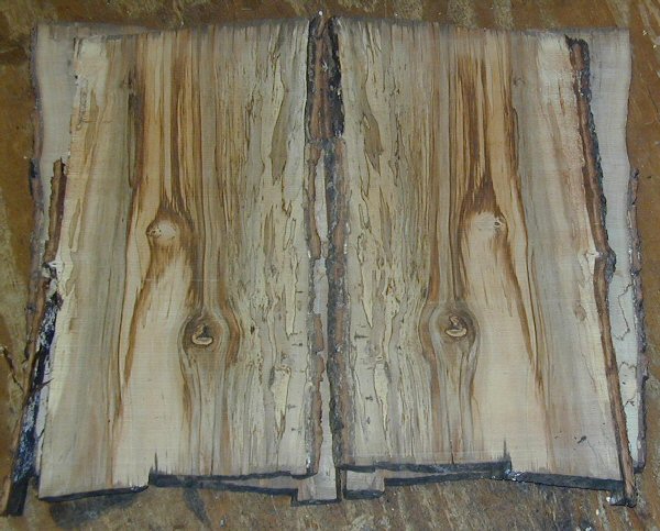

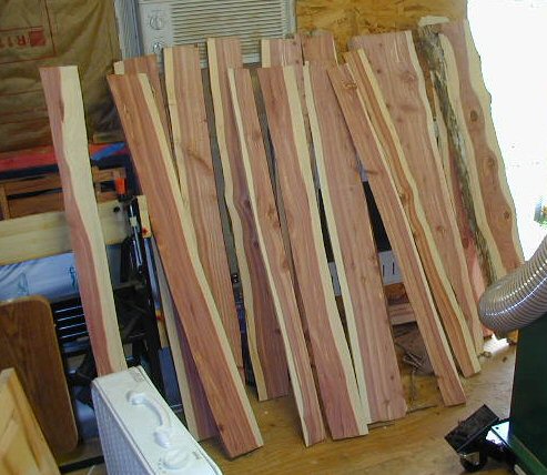

    The resulting stock.
    I won't do any more long stock until I make infeed/outfeed tables with miter slots matching those in the BS table, and a long version of the Wood jig, that's for sure.
