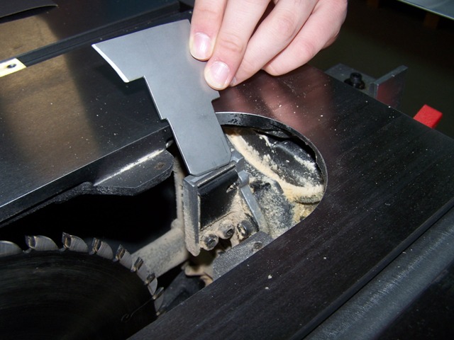

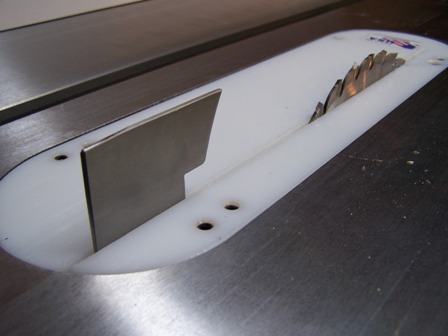

    I had my brother make a splitter from stainless that pops in and out pretty easily on my saw. It works well, although there's nothing to prevent lifting other than the friction of the spring....no issues yet.

        That ZCI is UHMW plastic from Peachtree, but they're prone to warping...it's no longer in the saw. Sears does sell a phenolic blank for ~ $29, but you can get a Leecraft phenolic blank lots of places (including Amazon) for ~ $20....any that will fit a left tilt Unisaw will fit the 22124, so I'd assume it'll fit the 22104 and 22114 too.
