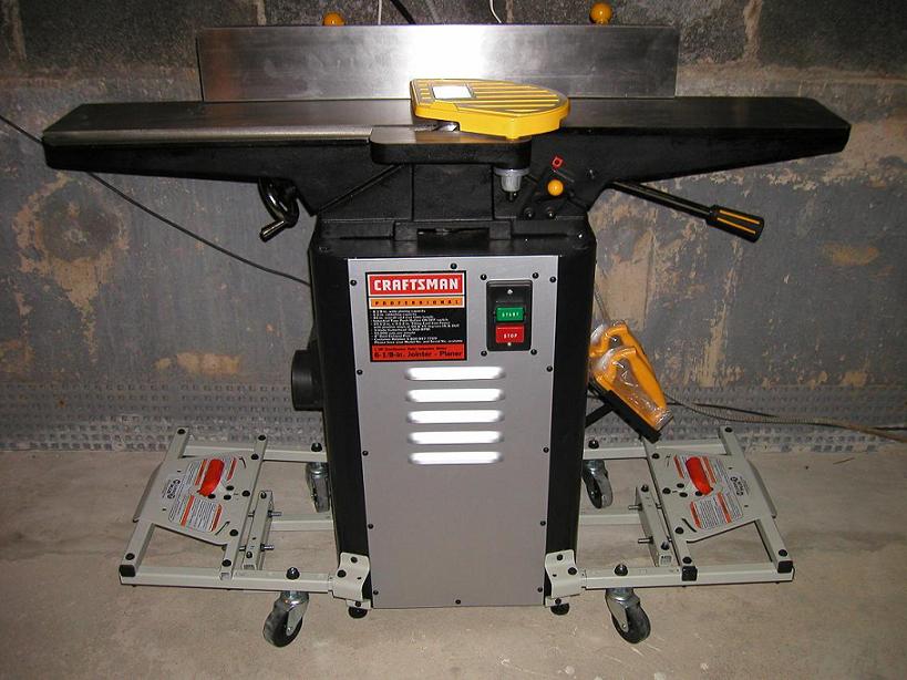

But then I came across these Ridgid Herc-u-lifts on clearance at HD for $8.70!!!
I have a dozen of them.
So no trouble cutting up 2 to make this base form my jointer.
Easy to engage and the machine sits on its own feet.
The jp610 I think is the only Ridgid tool that can not fit the lift with out some modification as well.Last edited by axa; 04-10-2007, 08:38 AM.Comment

I'm planning on making a fliptop cart for my Planner and will be using that herc-u-lift for the Jointer. Here is a thread about it.Joe SacherComment
Seems to work.I'm planning on making a fliptop cart for my Planner and will be using that herc-u-lift for the Jointer. Here is a thread about it.
Though engaging the lift or rather disengaging will be a bit awkward not having open access to the side of the stand.Comment
