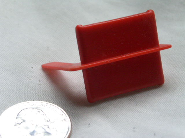

          As I said I took the wing and rails apart to move. So I started to put it back together (using the stock rails for now) and I can't tell where one part goes. I checked the manual but can't seem to find it. If you know what it and where it goes and have the manual handy can you tell me what page it's on. Sorry if the answer is totally obvious.
          Here's the part...
          *** EDIT: Nevermind, I must be blind. It's the rear rail connector ***
