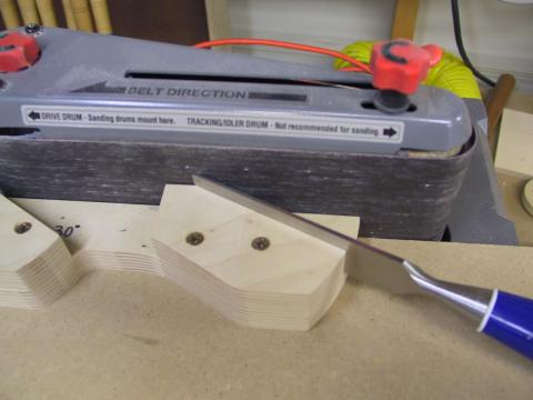

        Here's something else I do with mine (posted this some time ago):

                  Your sharpening jig looks interesting. How far do you go sharpening with it? Is it just to bring the chisels back from the dead?

                    Congrats on the OSS! Regarding the sharpening: I use it to form the main bevel using a somewhat worn 220 grit belt (which I don't use for wood anymore). Be careful to avoid overheating -- just as easy with a belt as a grinder -- I usually slide the chisel into the belt in 3 or 4 one-second "bursts", between checking my work.
                    Once this main bevel is formed, I go straight to a micro-bevel using sandpaper (Scary Sharp). After the micro-bevel starts looking like the main bevel, it's back to the OSS. In other words, any one chisel does not see the OSS very often.

                      Thanks for the little sharpening lesson. Will be using your pic for inspiration.
