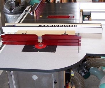

                      I built mine using melamine with a Rousseau plate and a home built router fence that saddles the Biesmeyer. It's attached to my 22124 in place of the original melamine extension. The table is 18" by 27". The fence is made out of birch plywood (pocket screw construction) with sliding melamine faces. I made removeable zero clearance inserts for the faces, but don't use them much. The area behind the face is a tunnel which I connect my shop vac to. Less than $100 and a good experience.

                        Nice setup!!! How did you fasten the table to the Biesmeyer rails? It looks to me that the only way to fasten the doubled - up MDF (top) is to drill holes in the side of the RT, insert threaded inserts and bolt it to the rails or just attach it with some 2 inch lag screws?
                        Thanks,
                        Wayne
                          Wayne,
                          The router table takes the place of the old melamine extension that came with the saw. I built a rectangular frame beneath the table that is connected to the existing holes in the fence rails with bolts and nuts. It works well and has stayed straight. Pete
