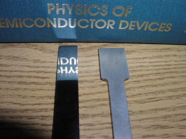

    First, here's a photo of the backs of two blades. The 1/2" Marples chisel is on the left, and the lapped, but not yet polished medium shoulder plane (MSP) blade is on the right:
Name:	Two Blades.jpg
    My backside lapping/polishing routine (Scary Sharp) for the chisel started at 150 grit (and stayed there for way too long for flattening), and progressed up to 2000 (by way of 240, 320, 400, 600, and 1200), finishing with green polishing compound on a leather strop. In comparison, I plan to polish the back of the MSP starting with ~600 grit, and working very quickly up to 2000.

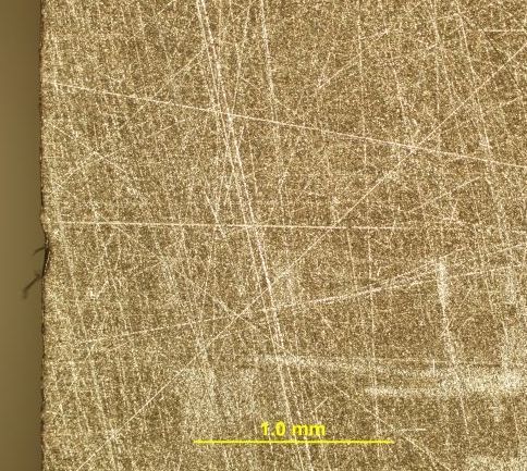

    Here's a couple micrographs of the 1/2" chisel backside (see scales in photos for an idea of the magnification):
    Low mag:

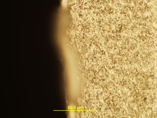

    High mag:
Name:	Back - 100x - SmallPic.jpg
    In the high mag photo, you can just make out the starting of edge breakdown. (This chisel has been used some since the last sharpening.) But stand by to contrast that amount of edge break-down with the MSP blade.

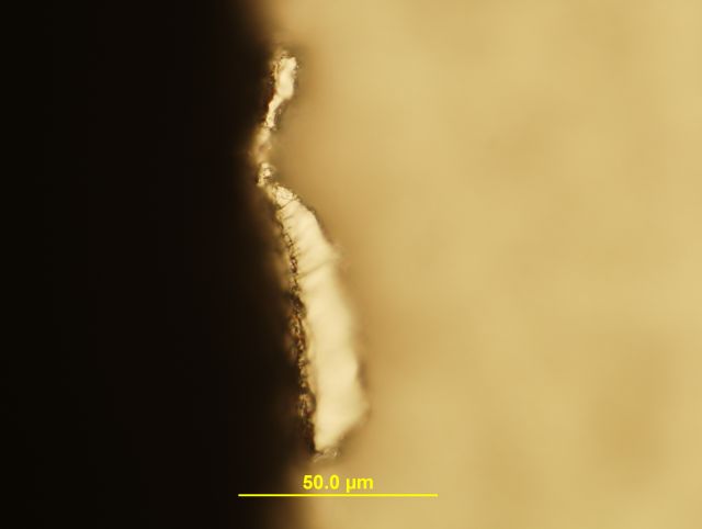

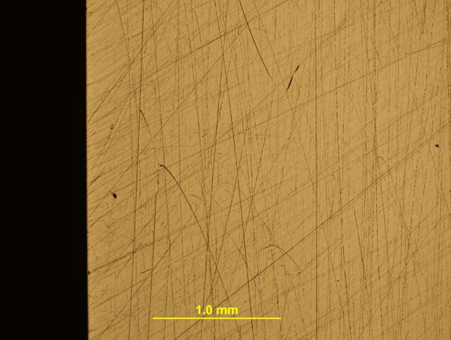

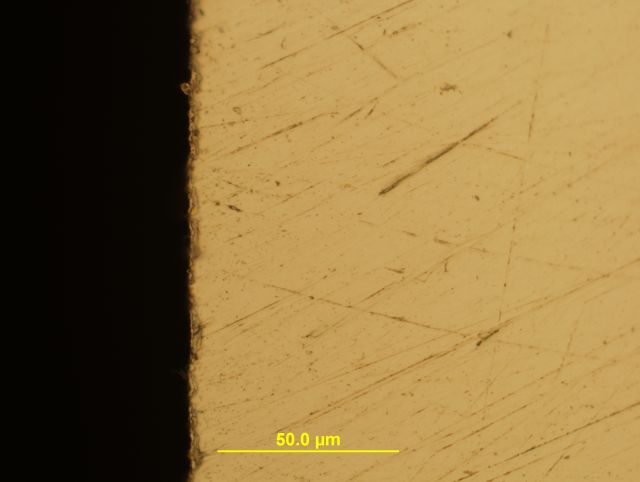

    But, between that, and banging it into some edge grain, the edge is very quickly breaking down, as shown in the following three micrographs; the first one being low mag, the second (high mag) focussed higher up on an edge fold, and the third (high mag) being focussed on the backside:
    Low mag:
Name:	Back - Bad Area - SmallPic.jpg
    High mag, focussed up on the fold:
Name:	Back - Folded Edge - Mid-Focus - SmallPic.jpg
    High mag, focussed down on the backside:
Name:	Back - Folded Edge - Bottom-Focus - SmallPic.jpg
    I think this breakdown is either attributable to using the edge before doing a better job of sharpening/honing, and perhaps leaving some remaining amount of burr which is folding, or perhaps the bevel angle is too acute to support the edge. If the latter, I'll need to put on a micro bevel. If the former, I'll be good to go once I correctly sharpen this thing. Either way, I should be slapped for punishing such an awesome blade like this; I don't expect to see it in this shape again.
    But, I think there's still a take-away message here about doing a good job of lapping the backside to remove the sharpening burr, and to sharpen to higher grit to lengthen the time between sharpening. Hmmm, seems like a mantra I've heard before....
