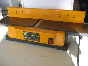

    Anyone heard of this brand?? It says it's a AMT 5-1/2" 7/8 HP jointer. I'm pretty sure it some Taiwanese HF type brand but for the price I don't really care. I'm just concerned about being able to get replacement blades for it.
    Good news bad news
    The good news is it's an American tool. That is the only good news.
    The bad news, AMT was bought out some years ago, by someone wanting their manufacturing capibilities. All woodworking machines and documentation was tossed, and no parts are supplied anymore. They had a 4 1/2" version of this that Sears sold (was a major AMT customer).
    You can probably get blades, but it probably won't be a local, conveinent source. It would be an aftermarket manufacturer.

        if you measure the blades you should be able to find replacements of the same size.

          Never owned a jointer before. How are the blades attached to the rollers? Will any blade of the same size work?

              Jointer blades are usually attached to slots in the roller spindle using 2 hex head set screws per blade. Some of the newer jointers have holes drilled in the blades - to simplify the setting of the blades.
              I am not familiar with this machine. However, chances are the AMT blades do not have predrilled holes in them. So any 4" blade without holes will most likely work as long as the blade is of a similar size and thickness.
              I don't know how old this machine is, but you may be able to get replacement blades from Sears Parts, if you can identify the model number of the Sears version of the Jointer. Some Sears retail stores carry jointer replacement blades and may have the required blade.

                Just looking at the picture, the blade mechanism looks exactly like the one on the ShopFox that I had. Can't be sure though.
