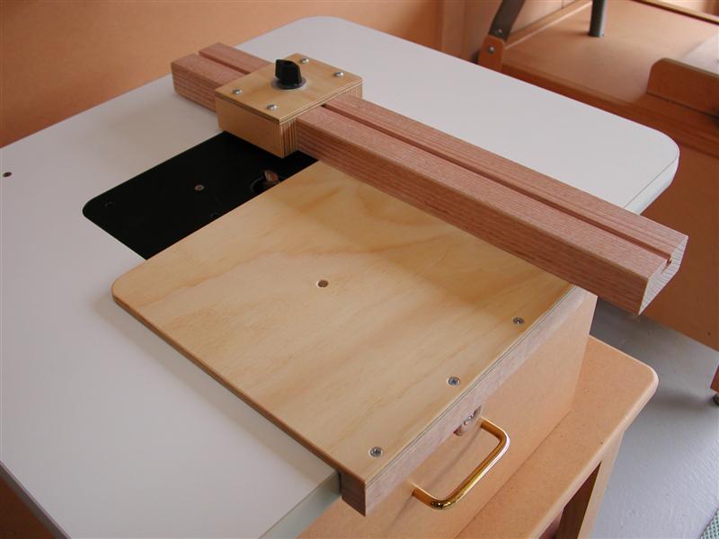

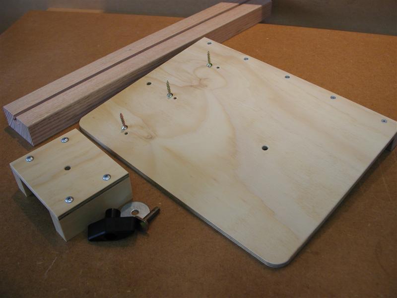

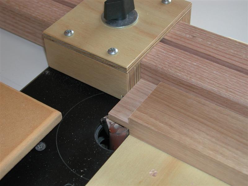

    Good day
    So, I needed a sled for the router table and, as you know me, I don't like to spend too much time and money for special hardware (that usually we don't have in Poland).
    The sled is made of 1/8' plywood, the runner is a strip of "Floor panel" and the fence is some laminated plywood strip.
    I used only Super glue so the construction took very short time.
    On the 7th pic that you see my old hand pressing the sled for gluing the fence, I actually pushed with my legs but it was difficult to take a pic...
    The sled is good only for the bit diameter that was used for construction or smaller (I used 3/8" dia bit).
    If you want to use it for bigger dia bit, just route it again with the new bit.
    Regards
    niki

      Good solution when you don't have a mitre slot on the table, which I do not have.
      Eric
      Be Kind Online
        I find it easier to let the sled ride the fence so I do not have to have the fence set square to the sides. My sled has a piece that goes into a t-slot of the router table fence that I use for feather boards which helps keep it tight to the fence. I made the base of 1/2 baltic birch because my main use for the sled is coping the ends of door pieces and I use a stacked rail/stile bit. 1/2 inch is almost right for the difference in elevation between these two cuts mininmizing the need to move the router.
        I have miter slots but rarely use them because I then have to set the fence parallell to the miter gauge slots. This isn't hard to do (I use a combination square) but it's just easier to use the coping sled.
