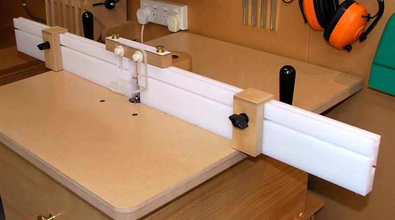

      Like this 1-1/4" hole in 3/8" MDF top, glued to 3/4" MDF base with a hole just big enough to fit the Triton base...
      (OEM base removed before attaching to the table)

      Downunder ... 1" = 25.4mm
