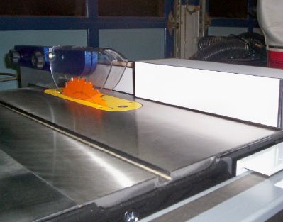

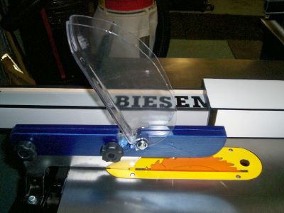

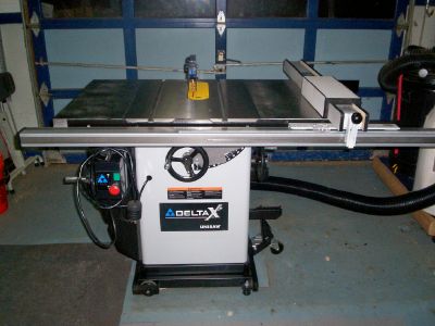

                        Cgallery...
                        My "bad" on the mis-interpretation of you comment on the Biesemeyer. I should have asked for clarification of what you meant. And you are correct that the Biesemeyer will move slightly when clamped.
                        As far as the scale that came with it.. I removed it and added a Starret tape which has very fine lines. All the fence guides I've seen have a cursor mounted on a piece of plastic. Every cursor I've seen will move if bumped hard enough and sometimes that can't be avoided at a TS.
                        So.... even thought I can set the Biesemeyer to say 12-15/16" on the scale and I am almost certain it is correct... I check the distance not once but twice with a framing square. My BIL who is a shop foreman in the machine shop at Delta Air LInes here in Atlanta took a black and yellow Stanley framing square and actually "squared" it to square. I then put a self adhesive Starret measuring tape over the stock marking on the square and I have my trued TS square. I did the same with a contractors sheet rock square so I can reach out and get big cuts when I do use sheets.
                        One might ask, why go to that much trouble with an accurate fence? Several reasons: I started WW in 1972 with a 50's circa Shopmate circular mounted under a piece of 2' x 4' ply on two saw-horses. Hole cut in center for blade to protrude through and saw screwed to bottom. Taped the trigger so the plug in cord became the off-on switch. Plugged in.. ON .... unplugged... OFF. Life was simple in those days! ha.. ha...
                        The fence was a piece of angled aluminun bar 2" by 2". You clamped it front and rear on the ply.... after you measured from the fence side blade tooth to the blade side fence. I measured from front tooth to fence and then turned the framig square over and measured from rear tooth to fence to get parallel and square.
                        Quite a few pieces of finished goods were done on that saw and they were done with a high degree of accurately. Not accurate because it was a super-dupper, top of line, state of the art, high tech fence as we swoon over in these forums....
                        It was done accurately because I followed the advice of my older uncle who was a much sought after carpenter and home builder until the late 50's when he passed away. It was advice he had gotten from his elders and they from theire elders passed down through 5000 years of Wood craftsman. My uncle never owned a power tool in his lifetime.
                        The advice was.... PAY EXTREME ATTENTION TO DETAL and MEASURE TWICE... CUT ONCE!
                        The Biesemeyer is as accurate as any fence I have en-countered. But was the cursor slightly bumped by me or someong when I was not present.. or have I in haste bumped the fence hard enough with stock or body to cause the mechanism to be slightly off?
                        It really doesn't matter that much to me. Give me the most tauted fence in the universe or a home-made piece of "rinny-tin-tin" and I am going to get an accurate cut because.......
                        I PAY ATTENTION TO DETAIL AND MEASURE TWICE AND CUT ONCE regardless of what fence I am using. That advice was passed to me and it has been passed to my off-spring and hopefully passed to theirs if this craft is too survive. Those words of wisdom generated from 5000 years of experience will never be never be obsolete regardless of all the high tech advances we have made. There is a certain of amount of resposibility the craftsman must shoulder. Put any tool in the hands of a true craftsman and he will find a way to make it work.
                        Sorry for mis-understanding your statement. In haste I may not have paid attention to detail and if that is the case... guilty as charged your honor! :>)
                        Regards and hope you find the match-up you're looking for!
