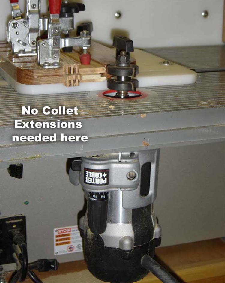

    Can't comment on the Freud but am very pleased with the PC 890/892.
    I permantly mounted an extra standard base on the accessory table of the bt-3100. It quickly can be dropped out for bit changes, the above the table bit change procedure was worthless for me. Another big advantage is the height you can raise the bits up through the table which is great if you want to add any kind of coping sleds, I'd say the collet pops up a good 1/2" above the surface.

          o i wish i knew of this site before i bought my ok ryobi router. i hate the height adjustment on it and definately need a collet extension. pc is the way to go.
          omar
