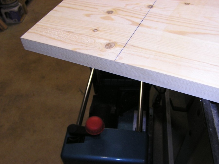

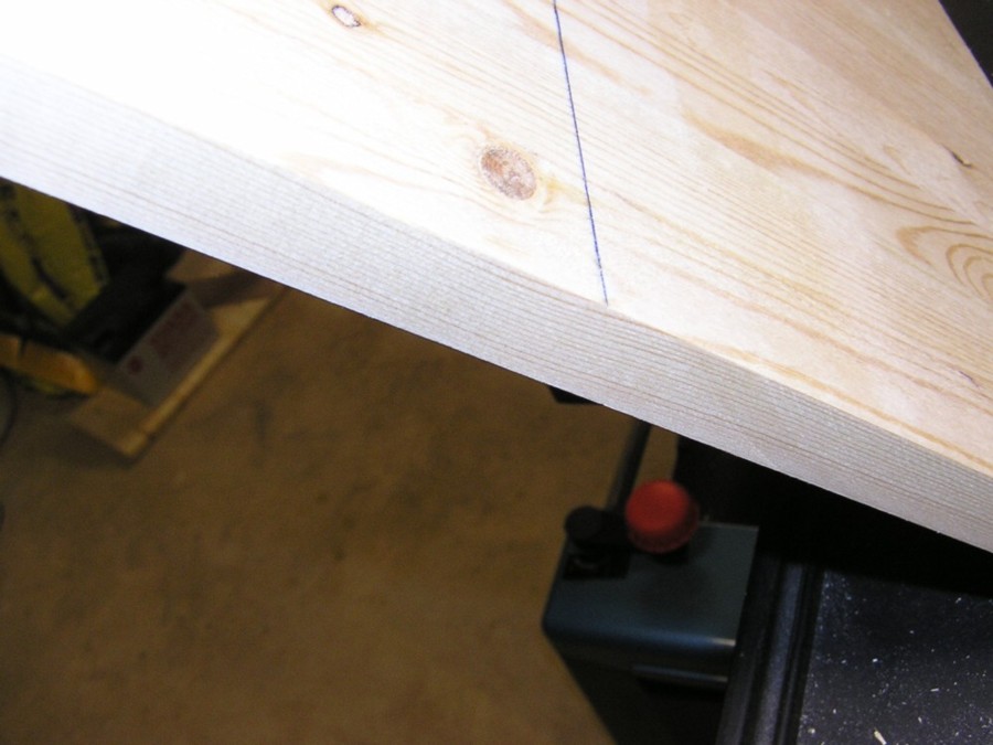

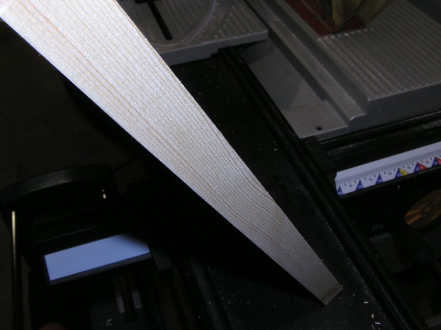

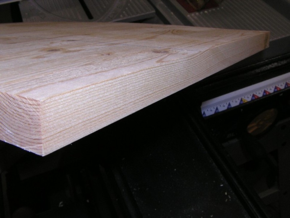

                Well I tried out my new flat grind LU87R010 today on a small piece of pine I had and it so far seems to do a great job. See the pics below if interested . I am using a BT3100.
                Steve
