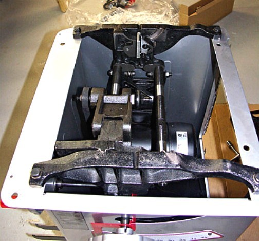

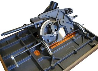

        Trunnion adjustment isn't too bad with either, but I do think it's easier on the zipcode b/c the 4 bolts are so easy to get to...it was literally 10 minutes including time to read the manual. The front bolts on a contractor saw are bit tougher ..once loosened the 3650's cam adjust is a neat tool. The good news is that it's not a big deal in the life of the saw cuz you'll probably do it once or twice.
        The mass of the cab mounted trunnions is significant. The 22114 weighs 385# according to sears website....nearly 100# more than the 3650...that's a large percentage heavier. The 22124 weighs in at 425#, and I really noticed a big difference in stability from my 300# GI contractor saw. That aspect surprised me because it's not something I had given thought to, but it's one of the things that makes it feel more like a full blown cabinet saw to me. It just doesn't budge.
        The 3650 uses a cast blade shroud to connect the front and rear trunnions. It's a more elegant solution IMO than the connecting rods used on other saws, but the rods on most of the hybrids are notably larger diameter and are indexed at the socket to prevent twisting. The location of the motor relative the to the rods helps reduce racking issues on a hybrid relative to a traditional contractor saw...which the 3650 is not. Racking has been as non issue with the Sears hybrids AFAIK.

        THere's a couple of pics below for your viewing pleasure...
