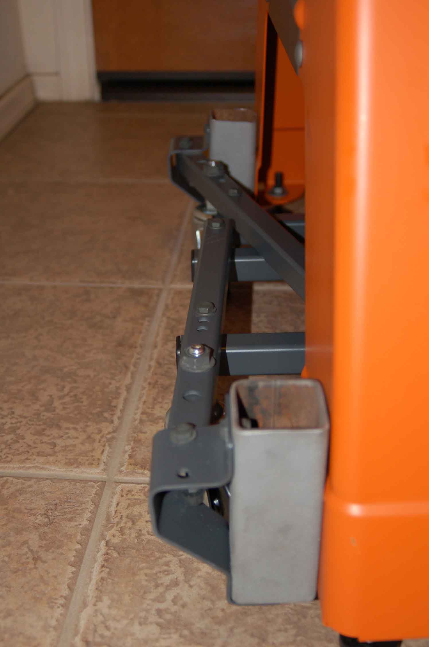

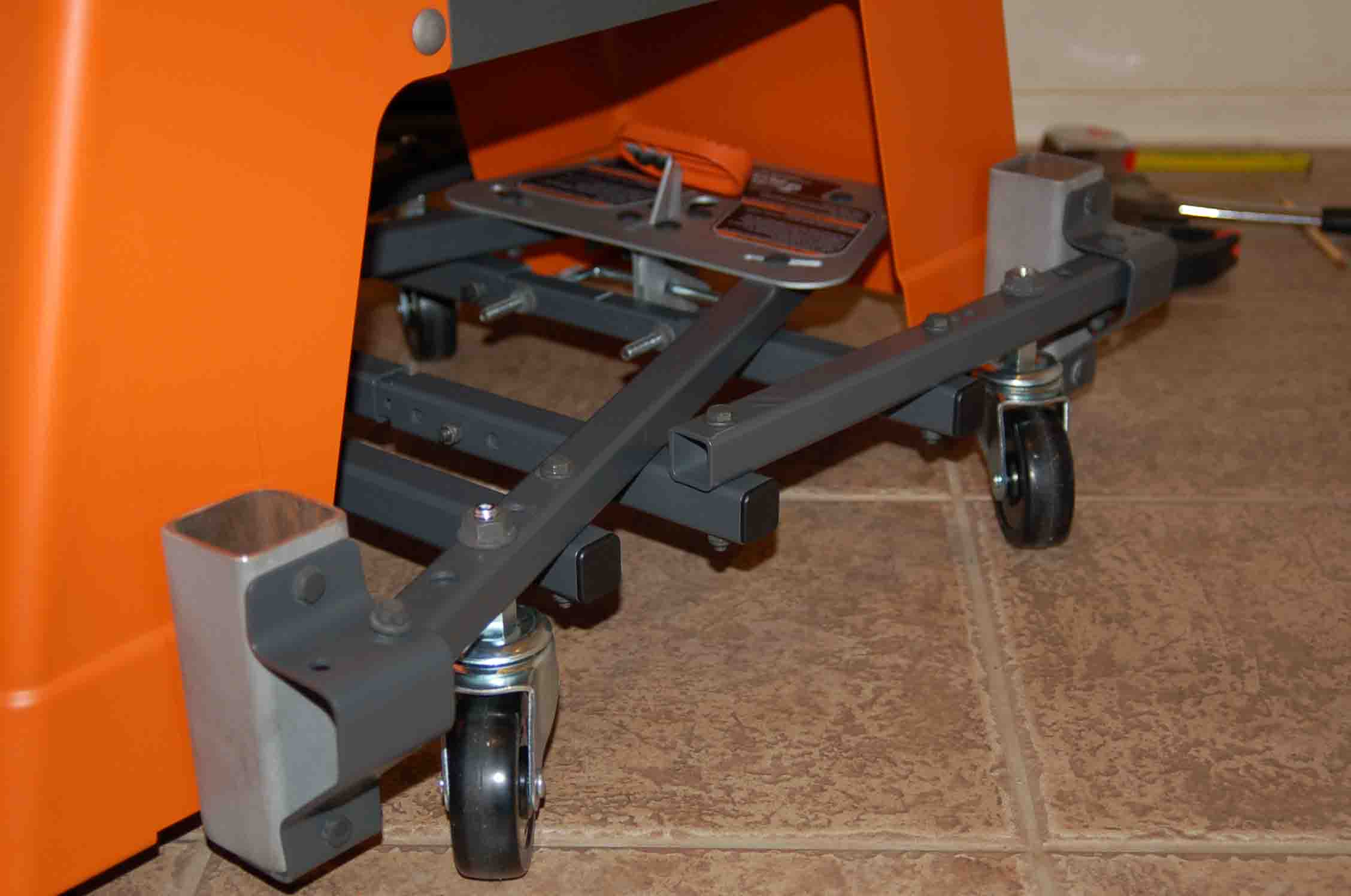

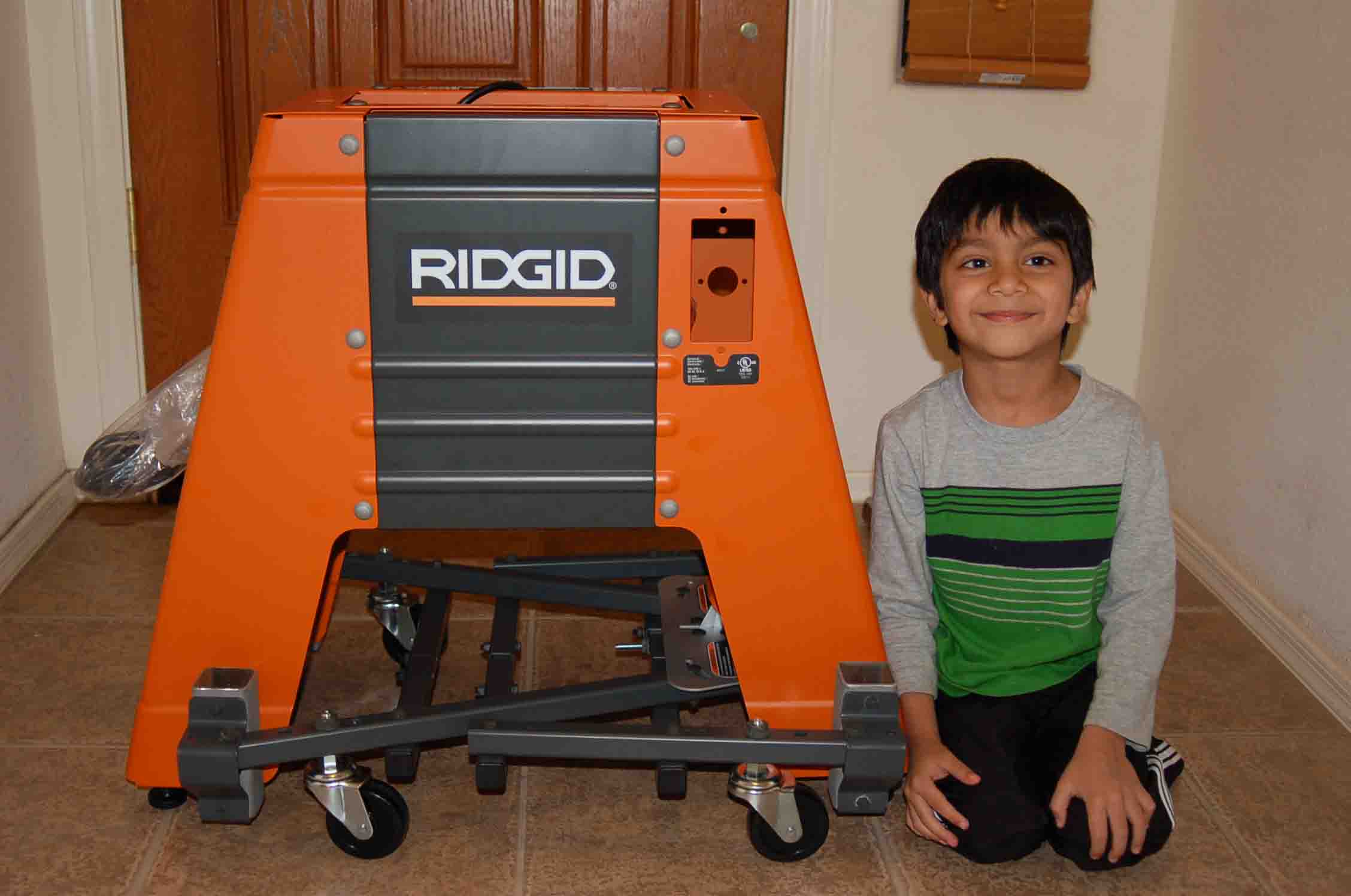

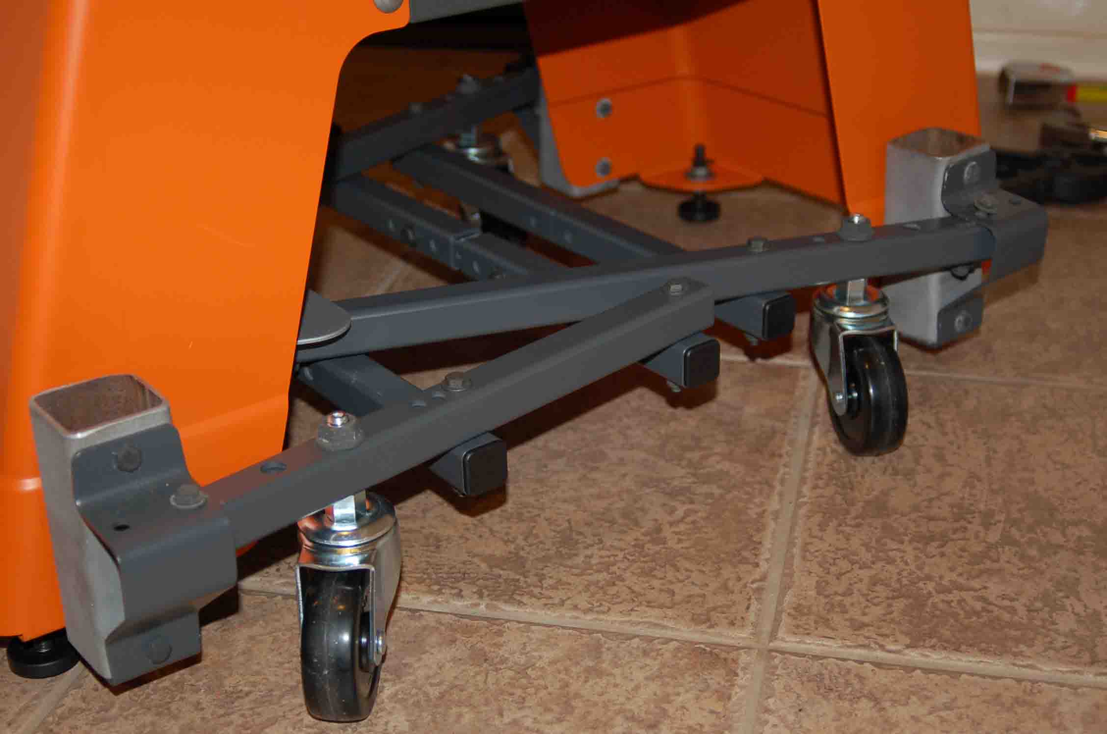

                      I THINK I DID IT! attached below are the some pictures of the modified herculift system. the first pictures show the front view, and yes, my son actually helped me screw in the nuts and most importantly handed me the tools (he loves it!). I ended up using the brackets for the outside mount. since the frame is ony 12" wide, i ended up putting 2" x 2" x 5" tall tube sections that i bolted to the frame first and then bolted the brackets to the tubes. now the total width is at 16" out to out. i have take some other pictures from different angles to illustrate what i did. it seems to work right now, but i dont know what is going to happen when i install the bed on top. i know, its going to be a task afterwards to engage the caster, but i have a plan and wont know if it work until i get to the last stage.

                        i've got the planer on and the lift system works great!
