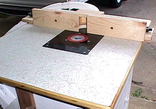

      I too have the Rousseau plate and am very happy with it. I put it in the router table I built back in April and it has seen a lot of usage.
