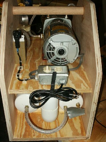

    When I built my vacuum press I wanted to do curved work over forms (besides flat panels) so I just went ahead and built a vacuum system.
    There are several sites out there on building your own vacuum systems, the one I used was this one:
    http://www.joewoodworker.com
    I got my pump off of EBay and most of the other parts from the link above. Here's the setup I made:

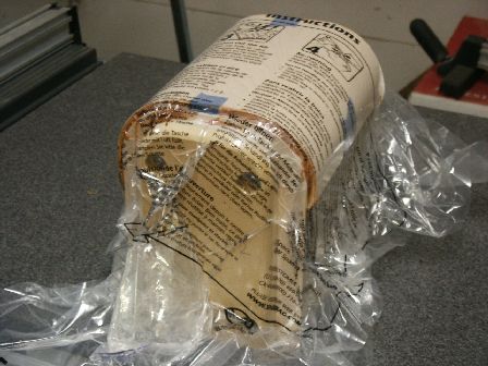

    And here's the first test press I did. It's 4 pieces of maple veneer I cut, using a space saver bag by the way:

    I used that very form to make this box:
