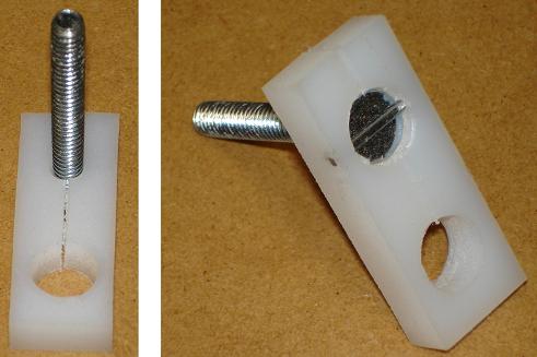

    When I had my BT10, I made my own out of UHMW or maple. When I go my BT3100 it was very nice to have standard slots in the accessory Miter Slot Table.

        That's what I made out of UHMW or maple. That adapter that fits into the slot and provides the friction to hold the featherboard in place. I got the idea from an aluminum one that I saw somewhere. It used a 1/4" flat head screw countersunk into the bottom of a block that was split from one end up to the hole so that tightening the nut would cause the screw head to expand the block a bit and bind it in the slot. Cut the block so that it is a very close fit in the slot so that it doesn't need much expansion to bind in the slot. I pinned the screw slot in the block to keep it from turning. Use a screw that is long enough to reach through your featherboard and hold the know for tightening.

          Jerry has gien you a solution. You can use either UHMV as he decribed or Highland Woodworking sells phonelic strips to use in mitre slots. They are oversize for a 3/4" slot. If you use UHMV, I would cut it slightly over also and take it down to "just right" with a card scraper.
          I build most of my mitre gauges and mitre slots at this point of the game as I end up with exactly "what I want" instead of what someone un-be-known to me decides I need. ha.. ha...
