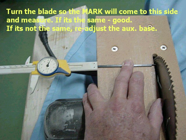

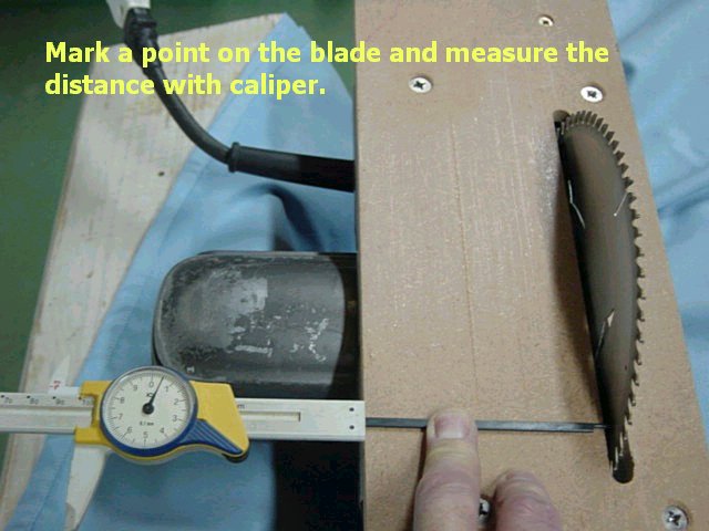

        • niki
          • 566
          • Poland
          • EB PK255
          Exactly what Leehljp and Crokett said
          I used 5/16" MDF and later changed to "floor panel"
          You can see it "in action" here
          http://www.bt3central.com/showthread.php?t=25370
          niki
