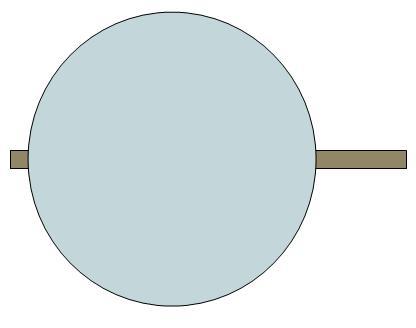

                            The distance the tooth must cut at a single pass decreases significantly as the blade is raised. Apologies in advance if my math is bad (plus I'm over simplifying this) but take the example of a 10" blade and a 3/4" thick piece of wood in the attached sketches. With the top of the teeth even with the top of the wood (most safe), the distance is about 2.75" whereas if it were possible to raise the blade another 4 or 5" the distance would be 0.75".
                            If you think about that cutting angle, as CabinetMan mentioned, a higher blade forces the wood onto the table surface and a lower blade forces it at you.
                              True, BUT if the workpiece raises up off the table -- the first stage of kickback -- the lower the blade is set, the less exposed blade there is for the workpiece to catch on and initiate a kickback. Or so my shade-tree logic says.
