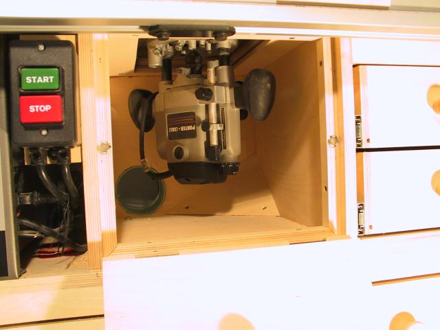

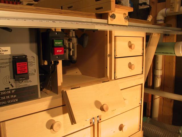

    I use my 7529 under the table, and find it very easy to adjust. I think I may be in the minority, though, or I just don't know any better. But, here's my setup:
    This photo shows the (home-made) compartment in relation to the saw:
Name:	Router Door Open.jpg
    The next photo shows the orientation of the router; the fine adjust knob is easily accessible. To adjust down:
    1. Rotate the fine adjust knob to desired position
    2. Release the plunge lock
    3. Let router drop to new position
    4. Re-lock in the new position
    To adjust up:
    1. Release the plunge lock
    2. Push up on the router to some position higher than desired & lock
    3. Follow all instructions for adjusting down
Name:	Router Comp Inside.jpg
    It's easy to push up on the router, even against spring tension, by using leverage off the bottom of the compartment.

      Oops, meant to show this as the bottom photo -- annotated to show the position of the fine adjust knob:
Name:	Router Comp Inside Annotated.jpg
      Regards,
