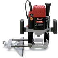

                    This is what I use. Only mine is the older model of this, the FT2000E.
                    A really good router.
