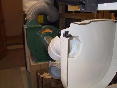

      Here is mine Chris. I have both connections made up and find the small one to be of some but not alot of value. Dust collects on top of the lower guides. I've heard or seen someone make a better shroud around the guides but I haven't tried it. I get very little dust left over in the bottom housing with this set up.
      And a link to the rest of my setup if you're interested. http://bt3gallery.fhauto.com/view_al...album15&page=1 I've made liberal use of duct tape (to build up the size of fittings, not to seal them) Pat

        Pat, you've got a similar setup to mine, although you've gone farther in adapting 4" holes where none existed before.
        FWIW, I discovered the 4" to 2-1/4" adapter fits the 2-1/4" dust port on the HF DC pretty well. I'm refering to the adapater that has the offset 2-1/4" hole, not the one with the centered hole.
        Normally the offset-hole adapter is meant to fit inside a 2-1/4" hole, but in the case of the HF DC it fits on the outside nicely.
        Just passing along one ever-so-minor fact in the lore of DC connectivity.

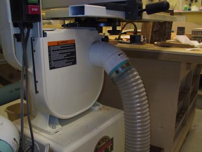

          I punched a hole in the door of my Jet 14". I didn't think of it as tough love, so much as punishment for showing up in my shop with a puny little 2" DC port. (Bad Bandsaw! No Timberwolf blades for two weeks!)
          If you're considering a second DC port in addition to one for the lower enclosure, I'd look into an above-table solution, rather than a second below-table port. A 4" line on the lower port is going to get most, if not all, of the dust that makes it through the throat plate. But there are a lot of situations where the dust doesn't make it below the table.
          BTW, I put my lower enclosure DC port as high up as possible to try to get the dust before it gets trapped between the blade and the wheel.
