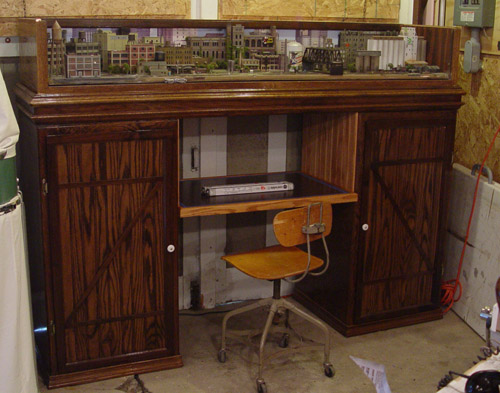

    Attached is a picture of the model railroad I'm building for my living room that you all share responsibility for because of this forum. I built hardwood furniture for it in the style I call "Early American Depot". My wife loves the work of the cabinets that I was able to do thanks to you all. I've never taken a project like this on...so stay tuned.
