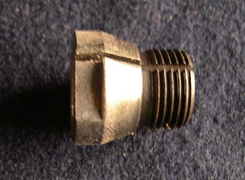

            The "Hitachi-style" collets, as shown in the following picture, have a shallow, steeply-angled shoulder which contacts a matching internal bevel in the router shaft.
            The collet itself has three slits, one internal, two external and the tightening action closes the collet around the bit shank. Due to the sharply-angled bevel, the amount of wrench rotation is small, but the effort quite large due to the robustness of the collet itself. Put simply, although you don't need to turn the collet far, you do have to lean on it a bit!
