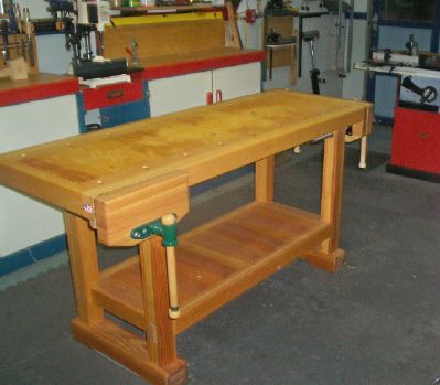

          I have the 9" Woodcraft. It's done everything that I expect a vise to do - hold and clamp. The quick release works well, and the handle is strong enough for me to lean on it when I need a tight grip. I've added some maple scraps as pads to prevent the metal jaws from marring workpieces.
          Whatever you choose, make sore to get something with a quick adjustment feature - it's so much better than spinning a handle over and over.
          -Joe
            Most of those vises are "knock-off's" of the now defunct Record vise (molds purchased by Anant in India). Just be sure it has an "acme" screw and lean on the guys that have posted for the how the cast has held up so as you can't take them for a trial run for a year. :>)
            Another option it to build to suit with wide or narrow hardware you can purchase from several places. I get mine at Highland Hardware just down the road. You can custom make the jaws to fit your work style and needs.
