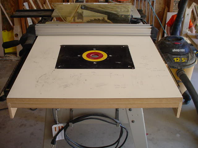

    I'm getting read to add a homemade miter slot to my BT3100 and I was curious if ther was a standard for the distance the slot should be from the blade. And if so should the left and the right side be spaced the same?
    I already have a extension table built on the right side and I was going to add another to the left before I install miter tracks.
    If there is no standard distance I'd like some suggestions as to what might be best.
