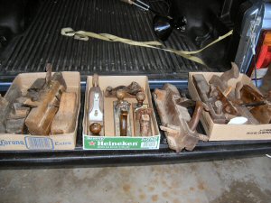

      I went to an auction last week and wanted to bid on two of the planes there. As usual they combined them with two other boxes of old wooden planes and started the bidding. I was glad I was able to get the whole thing for $25. They are not anything fancy (Craftsman) but the two big ones are servicable. Not sure what I will do with the other antique wood planes.
      Cut twice.... measure??

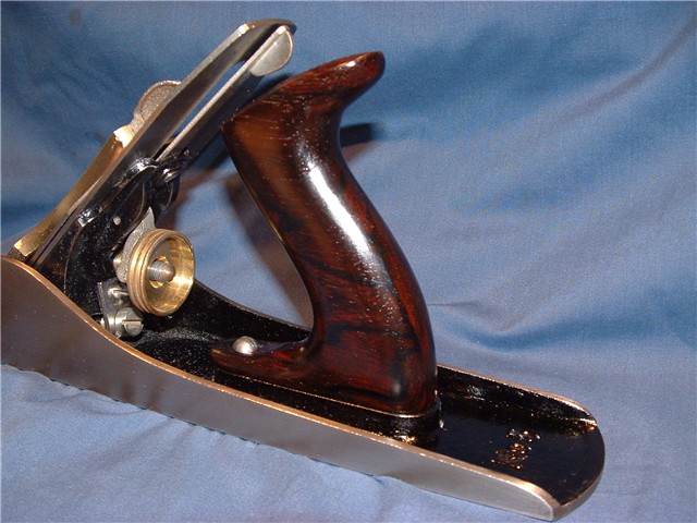

          Starting in 1902 the name BAILEY was cast into all Stanley planes either in front of, or behind the knob. With the exception of the #1 and early #2's, the number is cast into all Stanley bench planes. It's not unusual to see a Stanley lever cap on another brand plane. A quick way to show if it's a Stanley is to look at the end of the lateral adjustment lever. Should look like this one.
Name:	5C for MS totoe.jpg
          I would jump on the 5 1/4, assuming it's in decent shape with no cracks in the casting, severe pitting on the sole, or a damaged mouth.
