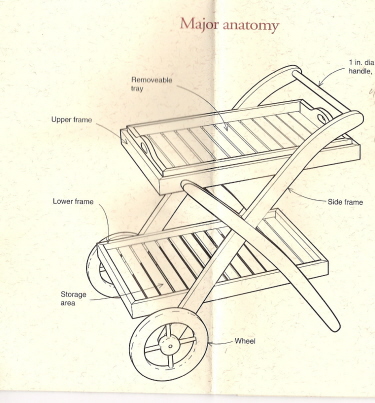

              Thanks for the tips guys. Sorry for the panic in my "voice" but this project is fairly bandsaw intensive, with resawing, tenons, and long curved legs.
Name:	Patio trolley.jpg
