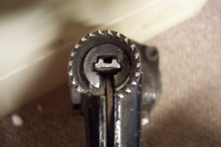

    Was heading through our local neighborhood garage sale yesterday and at one of the last houses I found a old Craftsman framing nailer on the lawn. Tag on it said $5, and the owner (a remodeler) said it worked OK with occasional jams. For $5, it was worth a shot (no pun intended). The only problem is that I forgot to ask the owner if it used full-head or clipped-head nails. I looked for a part # on it when I got home, but the label has worn off. I searched here, but found no information. Additionally, I looked on Ebay, where I found a nailer that looks exactly like this and is listed as part number 351-18320. I also looked on the craftsman.com web site, but it is "being updated" and has been the last couple days. Here are my questions:
    1.) Is there a way to tell looking at the striker if it for full-head or clipped head nails ? I have attached a photo looking down the "barrel" of the nailer.

    my geuss is that it is a 22 degree clipped head nailer, usually, full head'er are 34 degrees. I will try to find a manuel.

      I looked at a "Lowes Fastener Guide" I had around, and it lists the full-head nails at 21 degrees and the clipped head at 34 degrees. Are you sure you did not get your numbers reversed ?
      BTW - I got out my protractor and verified the angle between the "barrel" of the nailer and a line perpendicular to the long edge of the magazine is 22 degrees or so, so I do believe you are correct that it is a 22 degree nailer as you mentioned.

        Round head nails are usually listed as 21 degrees. However, to add to the confusion clipped nails range from 21 to 34 degrees depending on the brand. Your best bet is to call Sears with the model number found on ebay and test out the nails that they recommend.

          My PC framing nailer is 22 degrees and is full head

            Hmm... maybe I did get heads mixed up. But I got angles right. But that tip has "clipped head" written all over it.

                here is one that looks LIKE yours:
                http://cgi.ebay.com/CRAFTSMAN-CLIPPE...QQcmdZViewItem
                try going to HD and looking at the tips. The shape of where the nail comes out might tell you the type of head.
