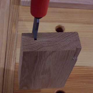

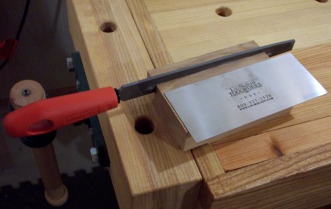

      I made a very simple guide to hold my file. It's just an offcut of white oak with a 1/8" kerf cut to hold the file.

      A few swipes on each side of the scraper, and the old milled edge is clean. Then I use the shank of a broken router bit to "draw" the edges out.
      I cheat for the burr. I use the Veritas Variable Burnisher. I tried rolling a burr myself, but I completely stink at that. I had a heck of a time getting a consistent burr. The Veritas Variable Burnisher showed up in my Christmas stocking.
      I'm glad I have it, because now I can get a consistent burr quickly. It makes tuning a scraper so much easier, and that makes using a scraper fun.
