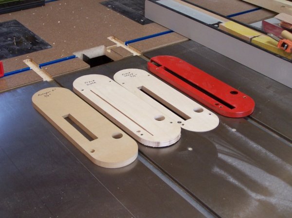

    Set aside other stuff to catch up on some of the small projects today. Finally got around to making some throat plates for the new saw.

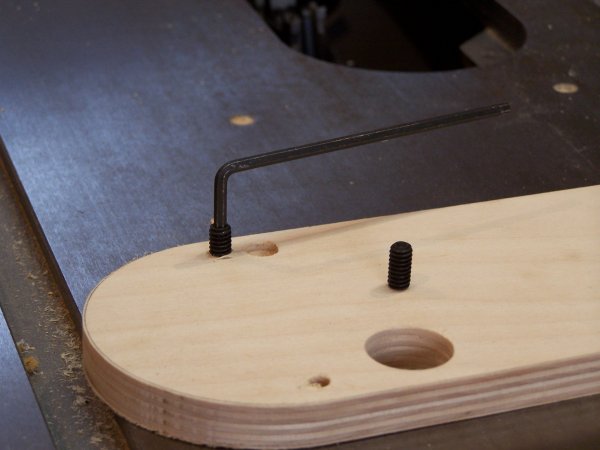

    1/2" Baltic Birch play and used 1/2" allen screws for height adjusters -- worked out great.
    A touch of sandpaper and some wax and I'll be set for a while with these.

    Not quite finished............
    Nice looking work!
    You might want to consider a dado/groove for a splitter to help prevent turning your workpieces into "missles"!
    Other than that, looks like really good work.
    George

      They look like they will work fine Stan but what are you using for a splitter?

        Yeah, I need to cut the slot in the back of the standard blade throat plate so the splitter will fit. Guess I should have waited until that was done.
