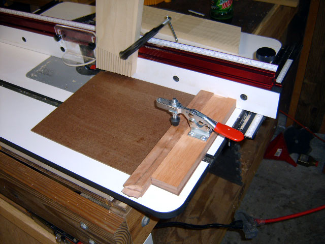

              I tried using the miter slot once. It was a pain to align the fence to the bit and keep it parallel to the miter slot. That was on my old craftsman but when I got my new JessEm I built a sled with a clamp and its so easy.
              Then the fence can be as cockeyed as it wants as long as its flush with the bit. Made 18 rails today and 9 stiles.
              I just finished making stiles thats why the feather board is still there. I don't use it (or need it) for rails.

                Originally posted by onedash
                Ray
                Very cool. So all you have to do is figure out how much higer you need to raise the bit due to the sled correct? I have a hard time with the narrow end when making my stiles (or is it rails?) and I think this is a great solution.

                  You can use the sled to adjust your bit after the first time because the profile is cut into the sled. It also prevents tear out.
                  The clamp was about $12. The rest was leftovers.
                  Just gotta make sure the fence is 90 degrees to the Edge of the sled. I just used masonite and glued a piece of wood to it but you could use plywood or plastic for the base.

                    I must be missing something. So the base of the sled gets ate up each time? That can't be. Is it away from the fence and the material sticks closer to the bit thereby the sled actually doesn't contact the bit?

                      The base of the sled (which appears to be the brown hardboard in onedash's photo) wouldn't come in contact with the bit. The bit would be set so that the cutter is above the base. The hardboard base rides along the fence.
                      The profile gets cut into the sled "fence" (i.e., the piece that the hold-down clamp is fastened to in onedash's photo).

                        So you have to replace the fence each time for different types of cuts? and how do you secure the fence to the sled, clue?
