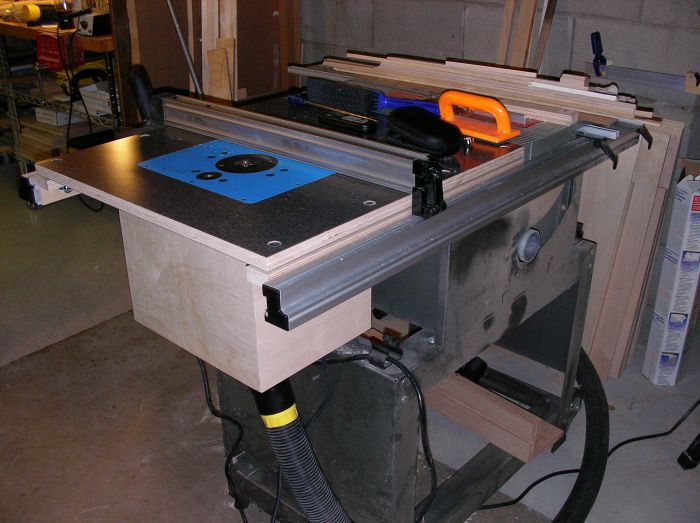

    I built an extension out of baltic birch, with down-draft table. Very flat, could be stiffened if needed (doesn't seem to), and uses the less-expensive Jessem (phenolic) lift. If I had money to blow I'd have used an aluminum lift.
      BTW, I looked at the phenolic-covered plywood at Woodcraft and wasn't impressed. It wasn't flat, and the lamination was very thin. I opted for some laminate from Menards (smaller piece was about $10 or $15). If you can find counter-top guys in your area you may want to do some dumpster diving.

          I have the Jessem Master-lift excel. When I first decided to go that route I thought I was spending way too much but I have not regretted it. If you can find it for that price and you can afford it by all means go for it. The ability to adjust the height from the front is it's strongest point. The mount is made for the PC 7518 and it fits perfectly and adjusts with repeatable precision. The fence is terrific but the miter slide is over kill. You will need the insert rings so you might as well get them. I got the rockler frame but if I had it to do over I would build my own cabinet. Good luck.

              Jim, Can you post a pic or two of that setup? I can try to picture it but a pic always helps.
              Whaler, nice space saving strategy with your setup there.
              Oh, and CG, love the built in downdraft!
