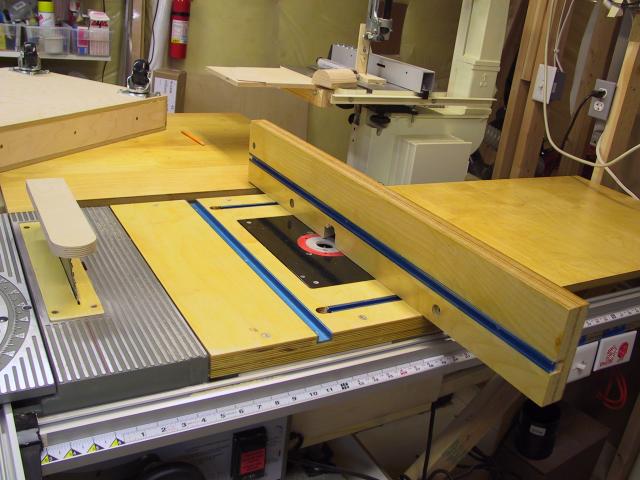

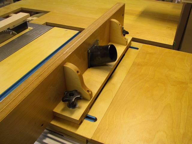

        What Ray said! Here's mine...

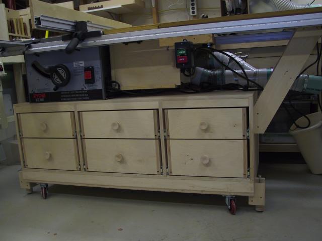

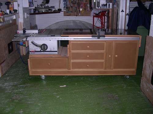

                    Ken: Here's my current router setup:
Name:	Router Table.jpg
Name:	Router Fence Back.jpg
                    Below is the in-progress new mobile base, but with the old router compartment, and old router table. This is the subject of Phase II of the mobile base project.
Name:	Mobile Base2.jpg
