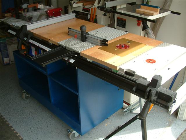

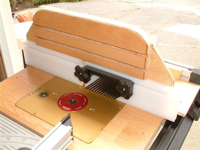

          I would be remise (based on my signature) if I didn't speak up. I make my tables out of 3/4" MDF laminated flooring. It is easy to do, durable as heck, less friction that plain MDF and DEAD flat! You can get laminate remants at flooring stores for cheap. I do the same thing for benchtops and custom fences.
