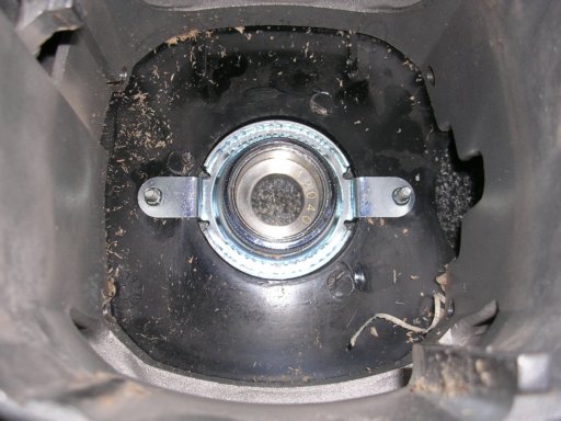

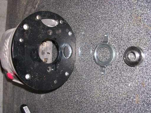

    I recently purchased the dovetail jig and realized that the Skil would not take the template guide. No real suprise and I wouldn't recommend any one buy this router. I was going to buy a universal base when I decided to email Skil. They have an adapter for my base that is only $7.50 shipped. I hope it works.
    This is the part number if anyone needs it. RAS140

    Am I going to have a problem?
    I got the part from Skil. The PC guide fits but the part does not seem centered.
    Do you think I will have a problem using in a dovetail jig or if I hold the router in the same position that the off center will not matter?

      I think you can cut dovetails fine if you are not perfectly centered if you keep the handles of the router in the same orientation throughout the cut. It is worth loosening the screws that hold the baseplate to the router, however, and trying to shift things a little to get better alignment. You have to be pretty well aligned with the jigs I have used because the dovetail bit is larger in diameter than the template guide and there is not a lot of clearance where the bit is closest to the guide. As long as you are dealing in a small mis-alignment it should work fine. I would test it in scrap first, however. I routinely cut the first pieces 2 to 3 inches long so I can test the setup and cut off 1/2 an inch if I do not like what I see.

          The Skil Router I have doesn't always lock up correctly. By that I mean the bit isn't always angled the same when I change height. Try to center it as best as possible when locking the height adjustment and then just keep the handles the same.
          I wish I knew more about woodworking before I bought my Skil router. It is 2-1/4 HP, I believe, but it really struggles with reproducable possitioning. But, I guess you can never have too many routers.

                  I would try centering if there is wiggle room. It looks like the base itself is out of alignment. My Dewalt router came with a special concentricity gauge, you might have to improvise.
