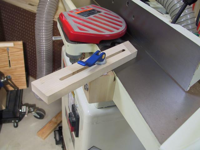

              • Tom Miller
                • 2507
                • Twin Cities, MN
                I just remembered this. It may not be helpful for 45 degree jointing, but it really helped me with 90 degrees; especially when the bottom surface wants to ever-so-slightly pull away from the fence.
