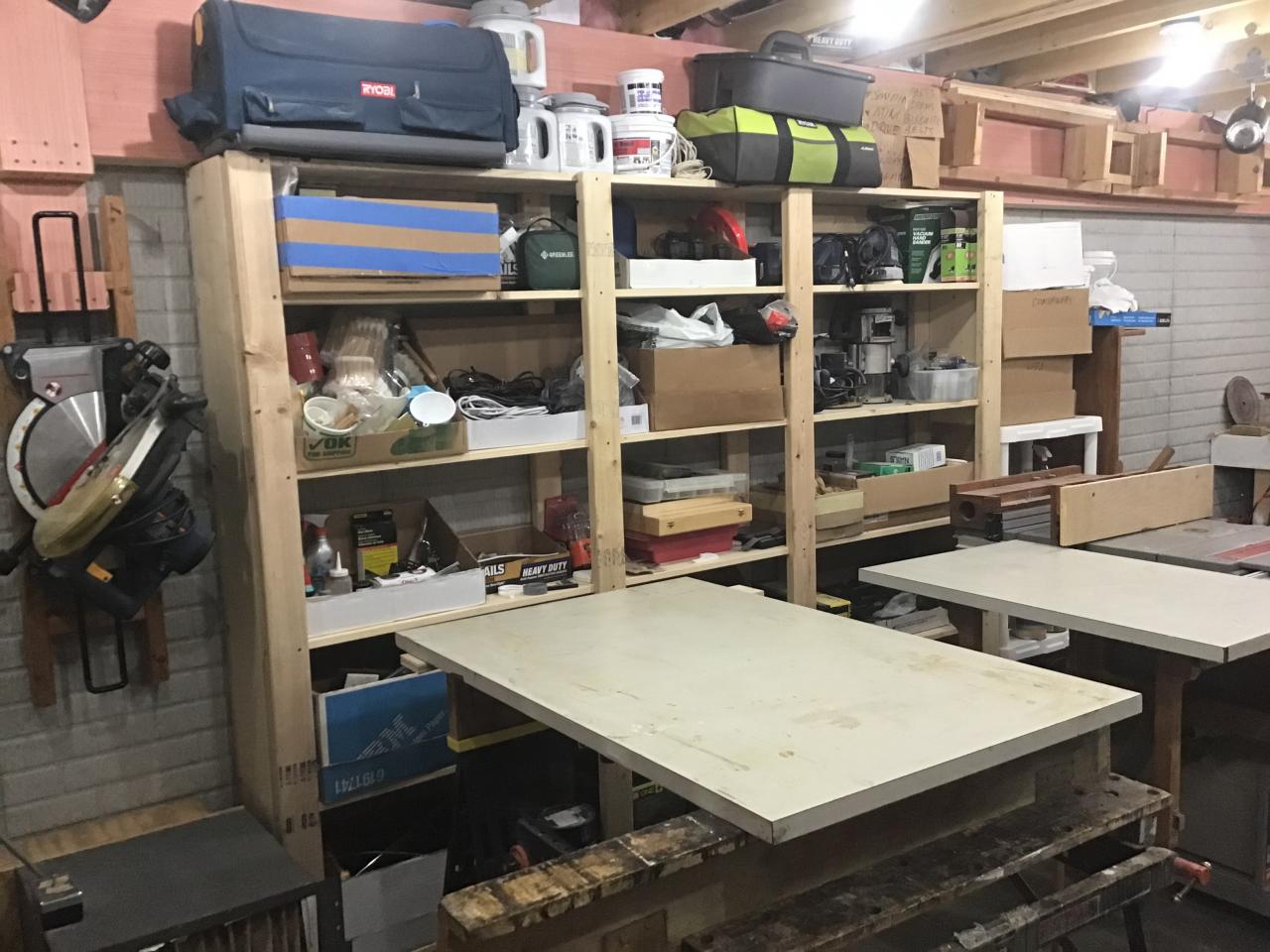

    i built a storage shelf for my new workshop using 1x12 lumber and 2x4 uprights. The unit is 7’ tall and 8’ wide. I used 2x4s for the uprights on the corners and there is a 2x4 on each corner and two spaced equidistance along the front (2 on the front and 2 on the back). The uprights were grooved for the shelves with a router. The unit was assembled with glue and screws. I also used a 1x12 for the end panels.
    Click image for larger version  Name:	70303629-EBE7-472B-9D84-FC9CC23A984F.jpeg Views:	0 Size:	147.6 KB ID:	839440
