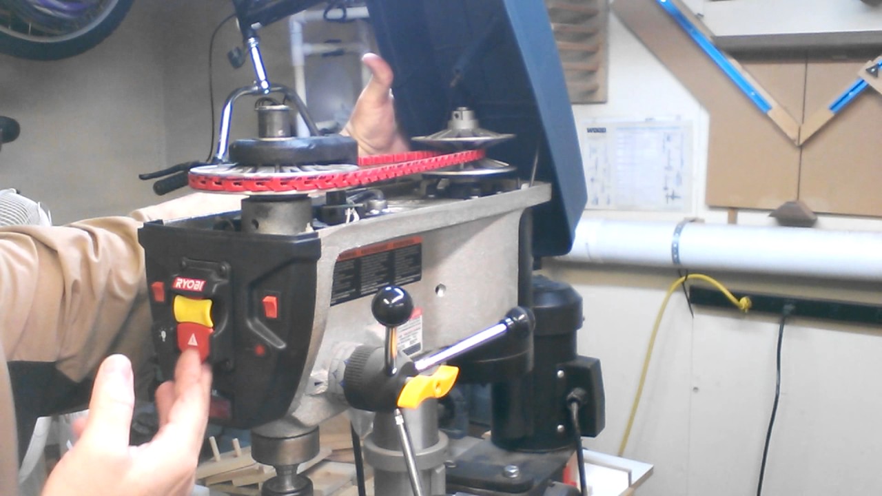

    I had the leftover links from the HF lathe upgrade, so decided to check if my Ryobi drill press used the same belt. It did, and here's the little project video. Thanks for watching!

      Somewhere a few years ago (10? or so), I found 3/8 in link belts. I bought some. I was in Japan at the time but I bought them at either HF or Grizzly. The 3/8 in worked better on my DP than the 1/2. The 1/2 just seemed like most of the belt was outside the groove than in it. The 3/8 fit and worked fine. Still is.
