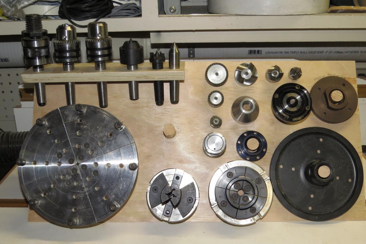

    My lathe chucks and centers were getting a bit disorganized, mainly shoved into drawers under the lathe, or on the workbench behind it, so I made a simple storage unit from which to hang them where they would be easy to identify and retrieve. The drill chucks and centers with their MT2 shanks required an 11/16 bit that I did not have, so need to acquire a Silver and Deming set (discussed here: http://www.sawdustzone.org/content.p...ing-Drill-Bits). This will be clamped to the workbench behind my lathe, right next to the lathe tool rack. Thanks for looking.

            Thanks guys. Used up some scraps in the making - the plywood face from a cabinet project, the mdf sides from a jig project, and dowels were harvested from a cast-off headboard I came across (all 3/4 inch maple). The chuck rack is tilted back 30 degrees off vertical, and the centers rack is set back 30 degrees to be horizontal. Nothing fancy, just glued and screwed. But I'm already feeling more organized and productive as I can easily find and select what I need.
