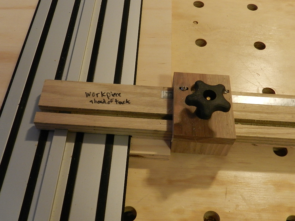

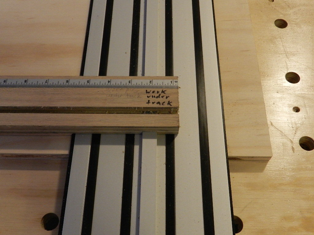

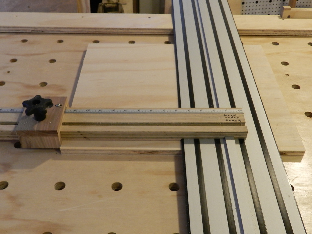

    I enjoy my DeWalt track saw but I don't like marking the workpiece and then cutting to the mark. I bought an Incra marking jig which is much better. But I still wanted to be able to work more like my stationary tools that I use with stops whenever possible. These positioning jigs have a dado that slips over the rib of the DeWalt track that the saw rides on and then has a movable stop to position the jig. One sets the track the width you want plus the width of the blade from the piece to be cut ahead of the track. It is used mostly for narrow pieces but can do wider cuts. The other works by positioning the track the right distance from the other edge of the piece to be cut where the piece you want is under the track. Quite inexpensive to make and work well. I like the fact I can clamp the track in place. I have a home made parallel jig that doesn't allow that and I find while most of my cuts are exact occasionally I am off a little.
