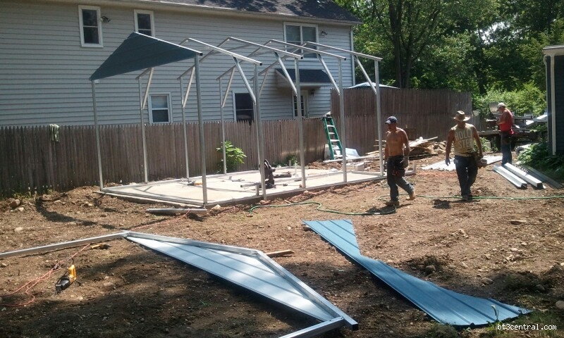

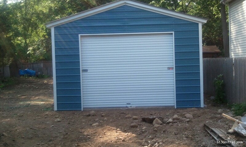

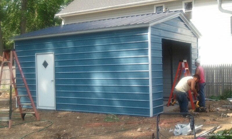

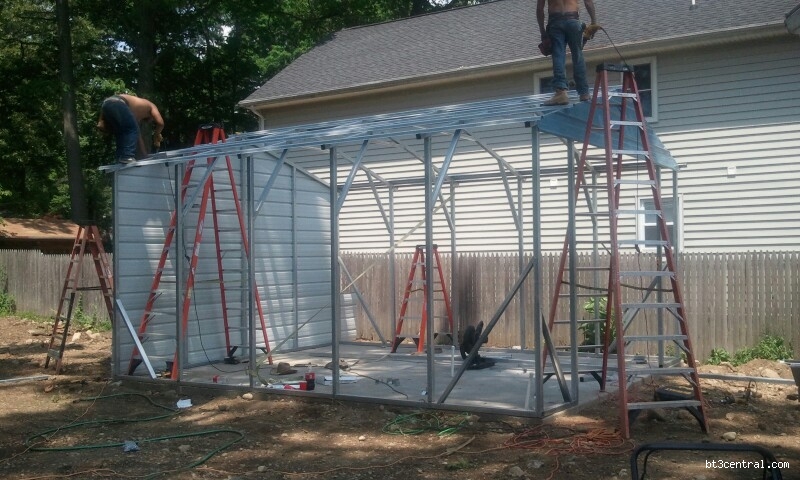

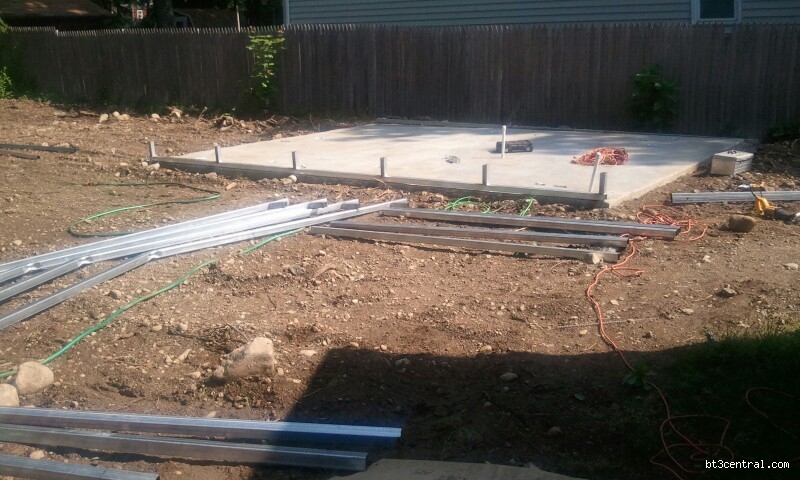

    I retired a couple of years ago and closed my shop.
    After two years of planing, I finally got everything together last summer and constructed a 16' x 20' dedicated shop at my daughters house.
    Here are just a few photos of it going up.

    Congratulations...looks good. Was it a kit?

          That's cool. After the slab, did it go up in a day? What are you going to do to the inside?
          • AAJIII
            • 306
            • WANAQUE, NJ, USA.
            • Steel City 10" table saw
            New Shop
            Cab,
            I ordered the garage on line. The price included delivery and installation.
            Paul,
            The shop went up in about eight hours.
            On the inside I used two part spray foam insulation and then 1/2" ply on the walls.
            I had a dedicated line from the panel in the house and put it underground.
            One 220v outlet and three separate 110v circuits. For lighting there are four 8' double bulb florescent lights.
            dimensions 16' x 20' with 9' leg height and 11' 6" to the peak.
            Al
