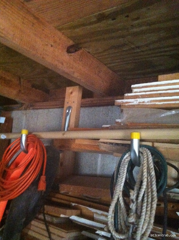

    West wall:

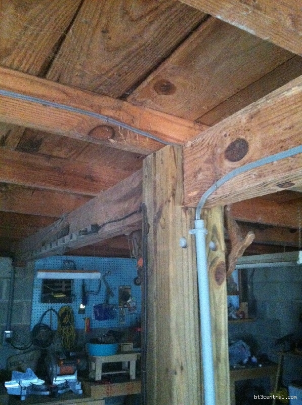

    Center post (Only 2 of the notched 4x4's are load bearing):

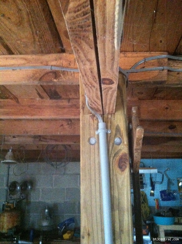

    Under the sistered 2x8 girder looking at center post:

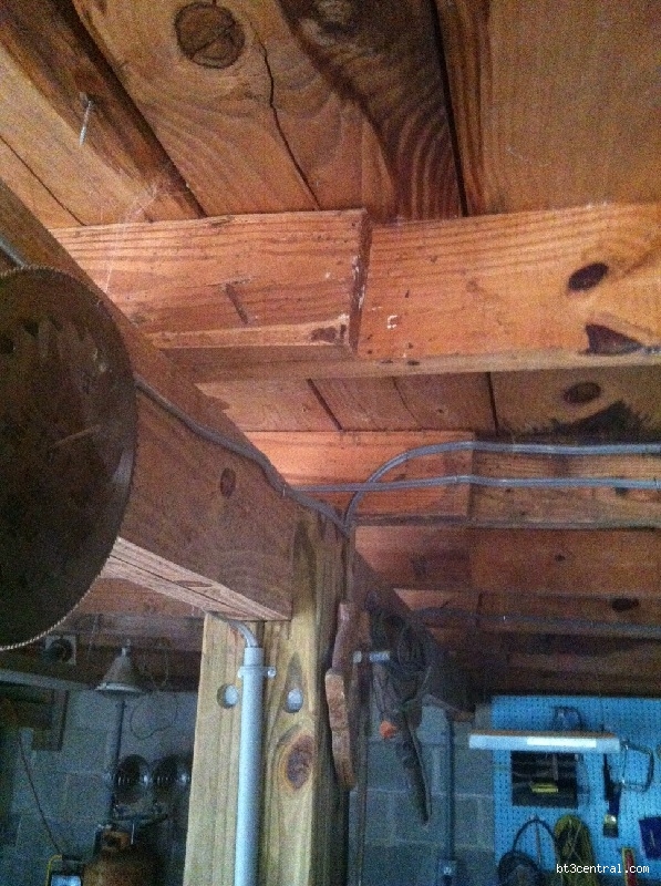

    Lap joint of the rafters and back side of girder:

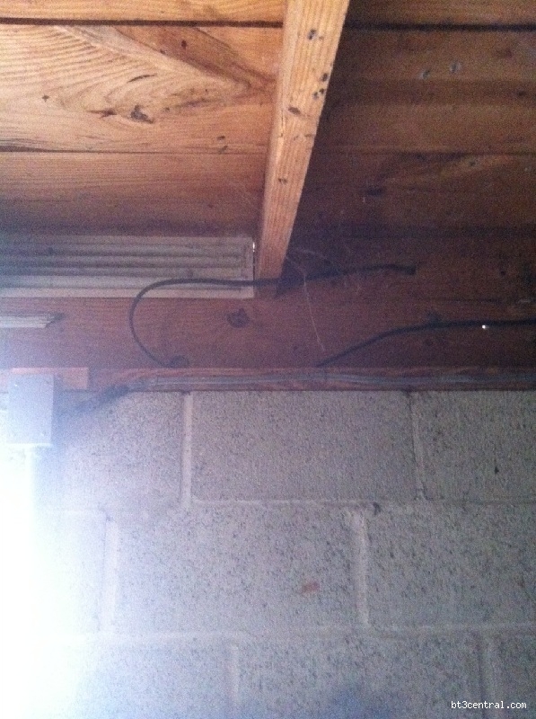

    East wall. Bottom of rafters are a little over 6' from the floor:
    I remember some of the previous post. I would suggest you do the minimum to get your roof in good working order. I do see where some of the leaks have stained the wood. I wouldn't try and get rid of the central support, it will probably entail more money than its worth.
    Work with what you have. Get some jack screws and "straighten out the lumber that has sagged and then sister up same size piece and bolt together. Use heavy square washers to distribute the load and use a w pattern. If you want to nail use 10d and also use a w pattern. On the block wall I would chisel out some of the rim joist to create a pocket where you can slide in the new lumber. I would put another short section below the rim joist, perhaps 4-6' and bolt that to the wall in several places to aid the old rim joist. This would be another good application for the screw jack or some clamps - you do want the new lumber in tight contact before you fasten them.
    After you have the structural items shored up, do your tear off and any removal of damaged boards followed by reroof.
    Sorry its not what you wanted to do, but why waste money at this point. It certainly will not be a pole barn without significant work and money, but at least it should be water tight and workable for a time.
