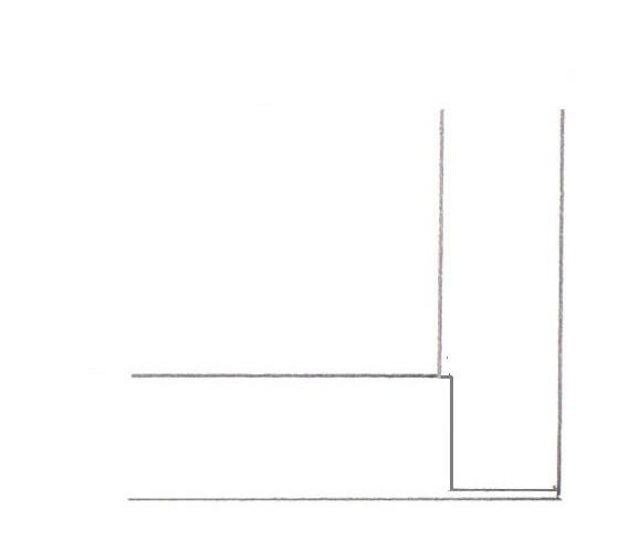

            In either case, you will have an unfinished plywood edge to deal with. I've used this rabbeting technique, which provides both good glue surfaces, and solves having the bare edge problem.

                The image I linked you wasn't oriented right (needed to be rotated). So, I fixed it. This is what works. This would be a bottom right corner (upper cabinet...front elevation).
Name:	finished rabbet2.jpg

                    C-man, are you using an 1/8" or a 1/16" for your rabbet? Do you glue and screw or glue and clamp waiting for the glue to set up some before screwing together? I assume that you predrill and counterbore.
                      A 1/16" is all that's necessary for hardwood plywoods. It's thin enough to just file off the overhang. I have just clamped it up in both directions, and have used brad nails.
                      For Melamine, I use 1/8", to get to a good glue surface for dadoes and rabbets, which is much better than just a butt joint. Fasteners are used.
